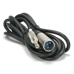

    va yek sooal dighi chi jor mishe fish xlr ro be kart seda vasl kar albateh bad az in ke powersh tamin shod?
    albateh be kart seda zs2
