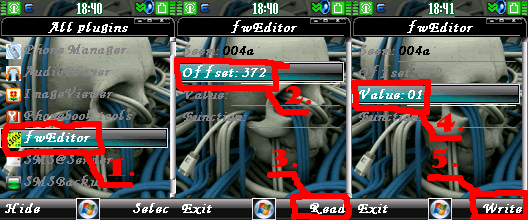

    ● Bass Boost:
    Offset: 372
    Value:0-Off, 1-On
    Visual instruction:
    6.Reboot

    Offset:436
    Value:0-Alphabetical, 1-last modified first
    ● Full screen java
    Offset:157
    Value:0-Full screen/No status bar, 1-with status bar
    ● Bluetooth standby time for 'find me':
    Offset:
    Value: in minutes, minimum 1,maximum 255
    ● Battery save:
    Offset:9
    Value:0-Off, 1-On
    ● Auto Track Switch in default:Audioplayer:
    Offset:160
    Value: 1-Forward, 2-Backwards
    ● Dashes in numbers(xxx-xxx-xxx):
    Offset:128
    Value:0-dashes betwen numbers, 1-no dashes
    ● Day on witch week starts in calendar:
    Offset:328
    Value:0-Sunday, 1-Monday
    ● Video record format:
    Offset:465
    Value:1-.3gp, 3-.mp4
    ● SIM card when starting up phone:
    Offset:77
    Value:0-not required(MPT wont be able to connest with phone then), 1-required
    ● Swap Ring style while holding # to...
    Offset:493
    Value:1-soft, 2-vibrate, 3-vibe then ring, 4-silent ,5-vibe&ring
    More might come up if ill remember bout something
    Special thanks to Manas coz MotoBeauty was my first flashed MP and through MB2 and Indiana, analyzing differences made me understand whats modding is all about .
    Also i would like to say thank You to JithinSK for making such a beautiful skins .
    Also big thanks to rest of skinners and to all modmymoto modding community, coz everything what i know ive learned here, not only reading guides but also reading every single post, problem and solution here throughout some bout 2 years, cheers.
