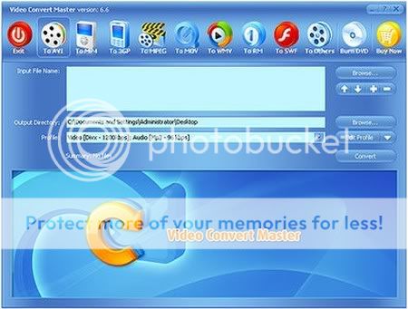

    McFunSoft Video Convert Master 10.0.10.2089 | 60.06 Mb
